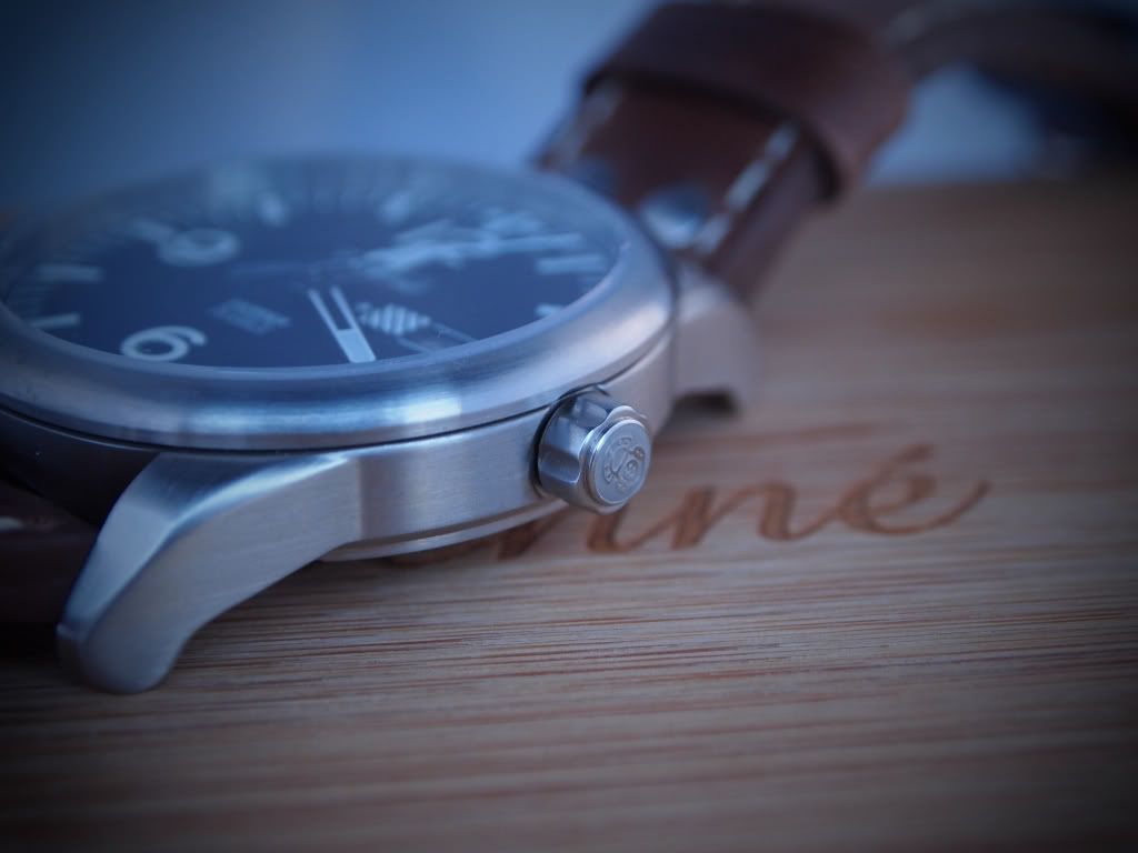

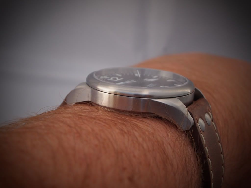

Case: The Harrier case is forged in brushed 316L stainless steel. I want to point out the multi-angle lug design which provide a rather unique look over many other off the shelf cases. The case does measure 41mm and with the crown right around 44mm. The case measure just slightly over 11mm in overall thickness providing for a slim look on the wrist. The lug to lug measures around 50mm which is a nice size that will look very nice on a wide array of wrist sizes.
The signed screw-down crown measures almost 6mm. The scalloped shape of the crown makes the crown rather easy to grasp and rotate. I found the crown rotation on this particular sample slightly rough and requires a bit of care backing out slightly to prevent a possible miss thread but with care no real problem. The crown engages in two positions the first for date setting and the second for the time. Both positions are smooth and work precisely as needed. The most interesting aspect of the crown is the dive helmet logo. According to Techné they wanted to emphasize the water resistance of the pilot watch at 50 meters meeting ISO 2281 standards. Future productions the dive helmet logo will be replaced with a script font "T". Overall the Harrier case has a very appealing case design, screw down crown and some decent water resistance for a pilot watch.

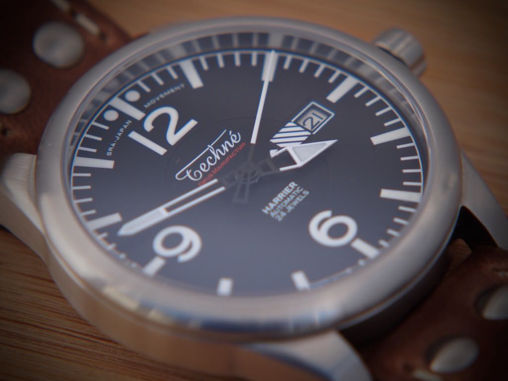

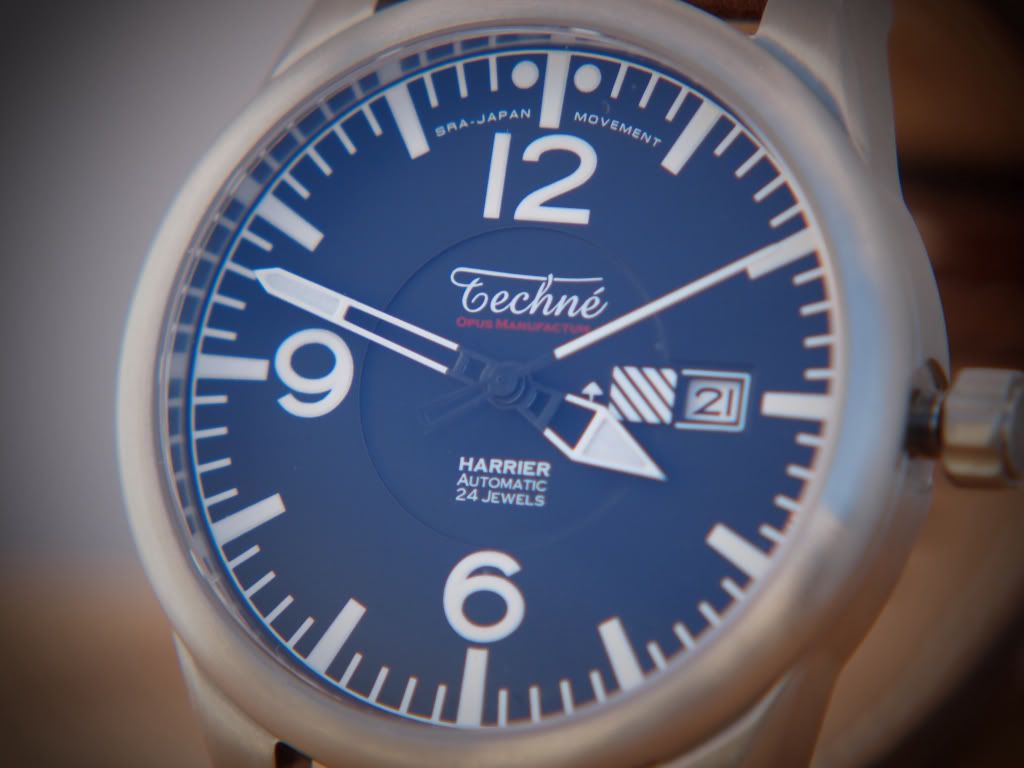

Bezel, Crystal, Dial and Hands: The bezel is fixed as with many pilot watches. The watch is fitted with an interior AR coated sapphire crystal with an opening measuring approximately 35mm. The nice dial opening size aids in the illusion of a slightly larger than 41mm case. The Harrier dial design draws inspiration from plane cockpit instruments and is uncluttered enhancing legibility. The most unique feature of the dial I believe is "Opus Manufactum" marked in red above center dial which is Latin for "hand-worked". All Techné watches are assembled by hand thus the notation on the dial. Various additional information such as the company name, model, and movement information are also neatly painted on the dial.
The dial features luminous and oversized minute marks and numerals painted with C1 Superluminova that aid in dim lighting legibility. The dial features dots on either side of the 12 o'clock position which allows for rather quick visual orientation similar to many watches carried by military troops in the early 20th century. A date window is positioned at the 3 o'clock position and is of appropriate size for easy legibility. Great choice of white date wheel and black numerals to correspond with the dial layout. The hour and minute hands are outlined in white enamel and contain lume near their tips. The hour and minute hands are skeletonized which allows the wearer to see the dial beneath. Great dial layout (airplane instrument panel inspired), sapphire crystal, and decent lume are fantastic features for a sub $450 watch.

On the wrist (7 1/2 - 7 3/4in): Great feel on the wrist. Slim profile and light weight.

Good review really nice watch! Question, what is the lined box right next to the date window at 3 o'clock? Looks to mimic an altimeter or other cockpit instrument but would like to know more as I've never seen that on any other pilot watch?
Pretty sure it is something related to an item on an instrument panel keeping with the pilot watch theme. I did ask if it was something specific to the Harrier. Maybe one of our military folks that may read will have some insight. Again pretty sure just theme related. Glad you enjoyed the review.
Discussion Starter · #13 ·
Definitely stripes from an altimeter. Franck from Techné wanted me to pass along......."The zebra stripes are directly inspired by altimeters (see below). It is not a mere gimmick: it helps to visually "frame" the date window and locate it faster at a glance; and it substitutes the missing numeral "3" by some graphics that take as much space and help maintain the dial's visual balance.
I have to say it does make the date window easier to immediately locate. Good orientation tool.
