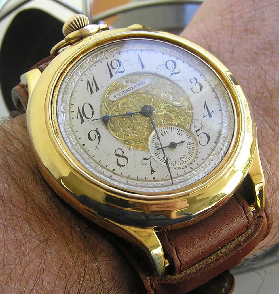

I've created an adapter, non-destructively converting my 1898 NY Standard 12s pocket watch into a wrist watch. I did not modify the original case, but instead designed a cradle that holds the pocket watch (from above) to my wrist. I think it is a disservice to history when someone welds lugs to the case of a vintage pocket watch to convert it to a wrist watch. This method is easily interchangeable between wrist watch and back to pocket watch, without the use of tools or damaging the watch. I designed the adapter using CAD, then uploaded the file to a 3D printing service bureau for production. They printed it in wax, created a plaster mold, then cast it in brass, hand polished and finally 22k gold plated. Next is to get a new strap that fits the lug dimensions. Overall watch diameter is 50mm.
Below you can see the three major parts, the strap, the pocket watch, and the adapter.

Thanks Scotty! I wanted a uniquely American made watch... I doubt I will see another like it! :)

That was my initial attraction to it, found it at a small town watch repair shop... unfortunately it is only a 7 jewel movement. If it dies, I will replace the movement with a higher grade.

Yes indeed, thanks much! I made two prototypes from plastic to check fit and make adjustments before I commited to the expensive version you see here. It actually fits two pocket watches that I have, which is lucky for me! I want to get a nice leather Bund style strap made for it next. Maybe in black.

I haven't seen anything like it, there is one that grabs from below, but it was made for 18s which is way too big for my wrist. I wanted something that made it look like an actual wrist watch, so this was my solution. I will say however, it is not a very practical solution. Vintage pocket watches are all over the place in external dimensions. The movement sizes are fairly consistent within a size (12s, 18s, etc.), but I have 6 size 12 pocket watches, and only two will fit this cradle adapter. As far as comfort, I do wear it a little snug to insure it stays put under the cradle, and it is significantly heavier than a modern wrist watch, but not so much that it is a nuisance. A major downside is that a vintage pocket watch lacks a couple of critical items: water/dust resistance, and no shock resistance. As such you have to be a little extra cautious when wearing one on your wrist. FYI, I have fairly tiny wrists at 6.75 inch. It would look more at home on a larger wrist. ;)
